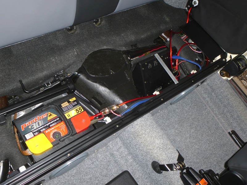

It's not connected yet but I like to solder the larger "special" eyelet and spade connectors. Easy to reuse this way.
I had a few used large eyelets at hand but non of them had a diameter large enough to fit the seat belt attachment bolt.
So I bit the bullet and tailored one...

Finally... Battery back in and basic woofer setup done...
=0
Temporary glued a toothpick to the phase shift control so that I could reach back and do adjustments while driving...
Conclusion...
I'm glad this project is done at long last. The system's sound is better than expected.
That little woofer produces some astonishing "oomph". Even the rear mirror shakes at higher sound levels.
The down side is that my Bug's interior noise is ridiculous.
At 50 mph it starts to get really loud due to the dual carbs and the deep tuned Sebring exhaust.
Additional loud music will not add to the recreational experience...
Anyway, back in the day I would have loved it! "Everything Louder than Everyone Else"
