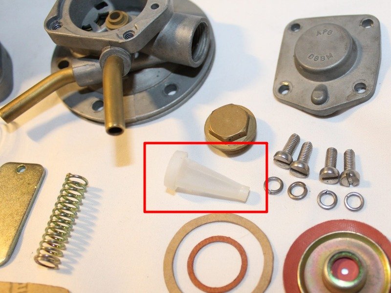

Also replaced the fuel filter...

fuel filter mounted under the tank before the hardline in the tunnel?
Yep, moved the fuel filter from the engine bay under the tank about 12 years ago.
I like this solution better than the location in the rear near the transmission & heater box.
As for potential "debris" from the fuel hard line ...
The Pierburg fuel pump I have has a filter element which can be accessed, inspected and cleaned easily.
Wow, that's a gorgeous fuel pump!

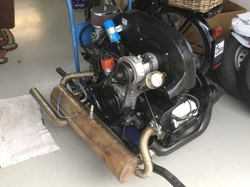

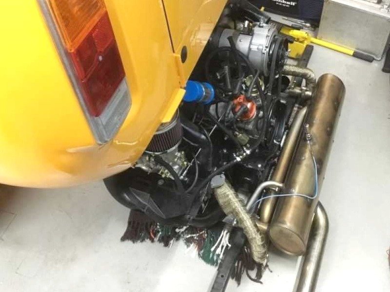

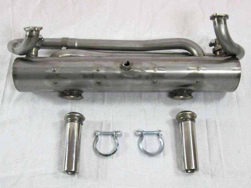

And just ordered this: https://www.ahnendorp.com/VW-Kaefer-Typ-1-Motorenteile-und-Bearbeitungen/Auspuffanlagen-51/Ahnendorp-Customsport-VW-Kaefer-Typ-1-Auspuff-1.html
Wow, that's a very nice exhaust! What's the bung for, in case someone needs an O2 sensor?
Yup, for an O2 sensor. Its position on the muffler is a question in dispute however...
