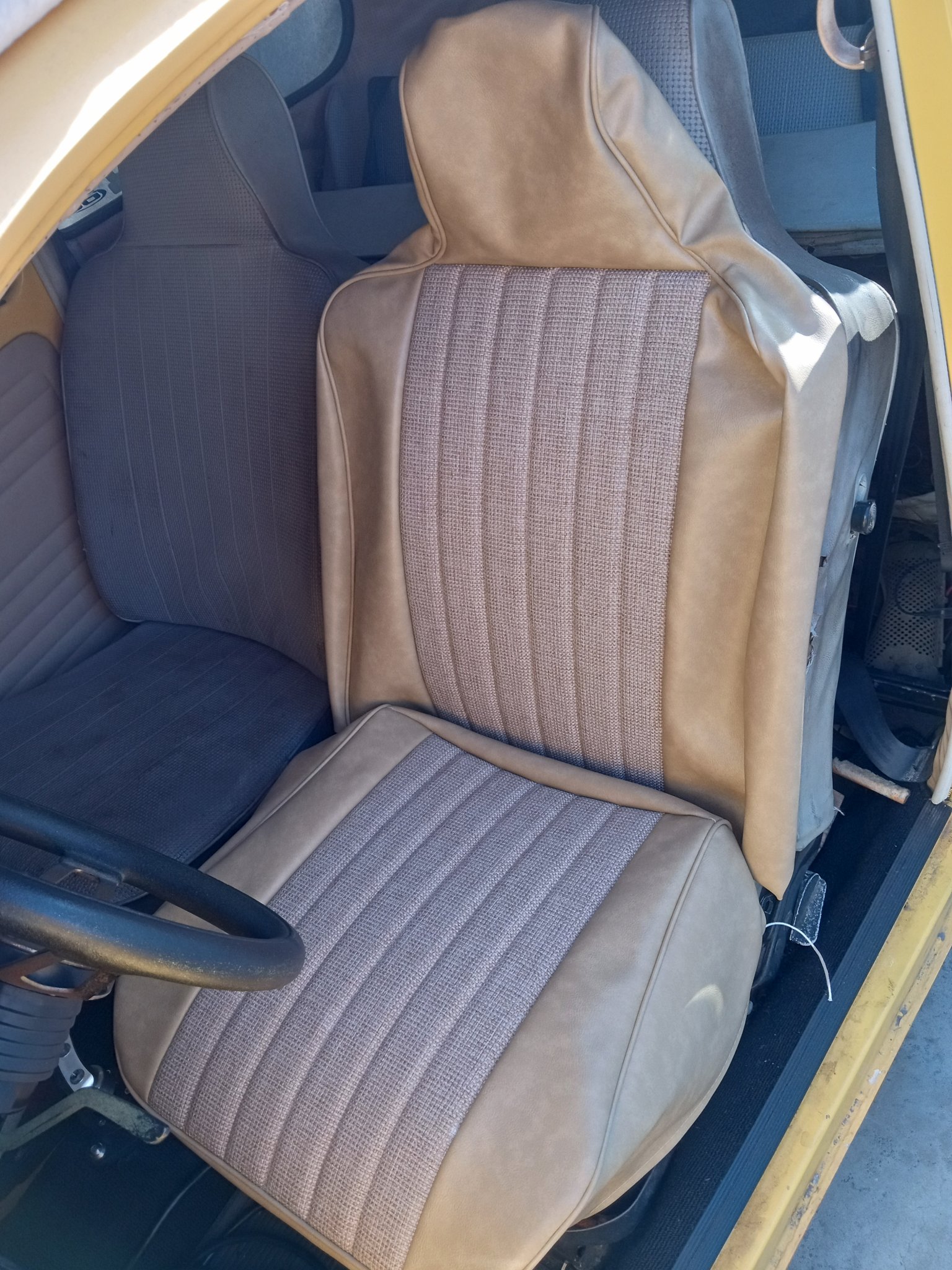

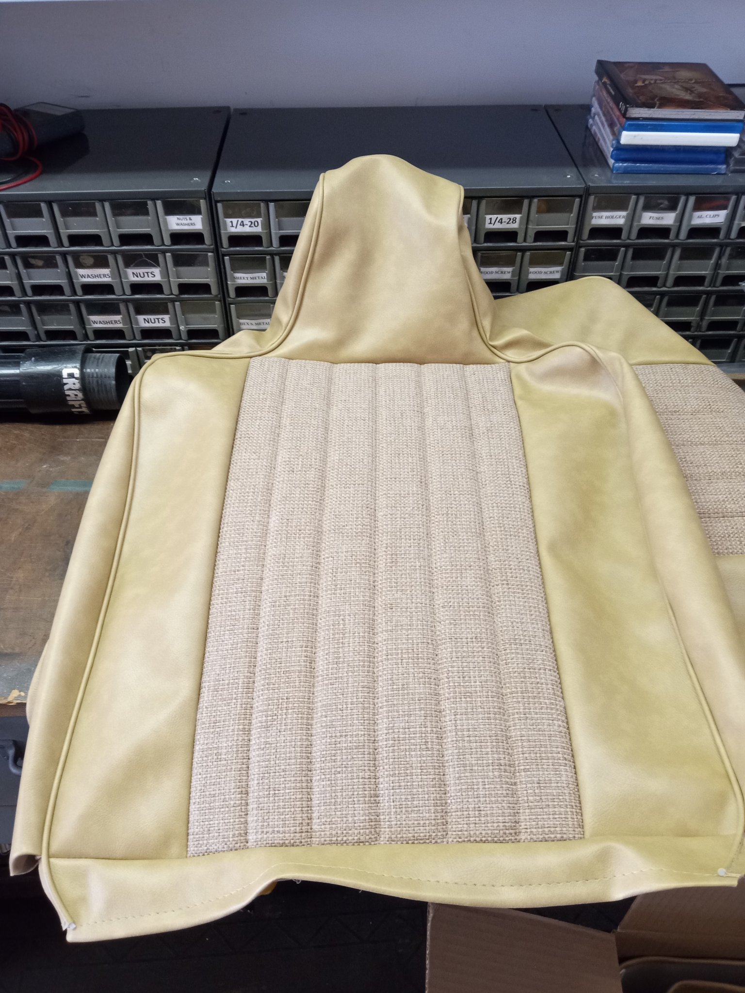

alright, after not touching this thing sense like October i did a thing. well more accurately i spent some money. hit up TMI and ordered seat upholstery. went with Saddle vinyl with Sand Tweed Cloth insert.
TMI isn't far from Wolfsburg West, so when i go pick up my upholstery ill swing by there and get the OG style hair seat pads and probably some other odds and ends.

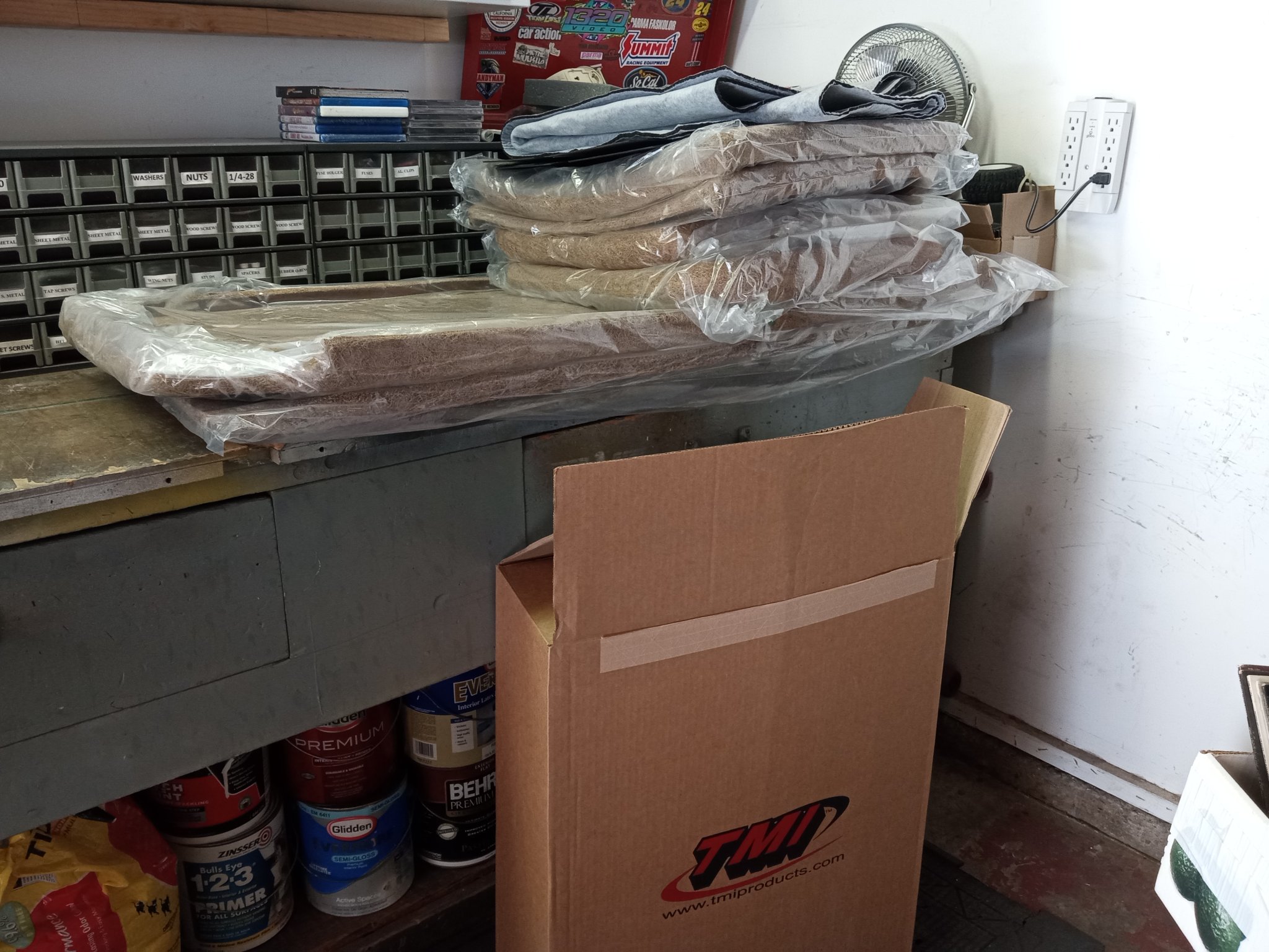

i did a thing. ok not really. well kinda. i drained the 2 year old commiefornia gas out of the tank over the weekend. mower seems to run on it fine. but i also stopped by TMI and Wolfsburg West this morning.
They look fantastic. I really need to bite the bullet and do the same. Sitting on 70 year old horsehair kind of blows.

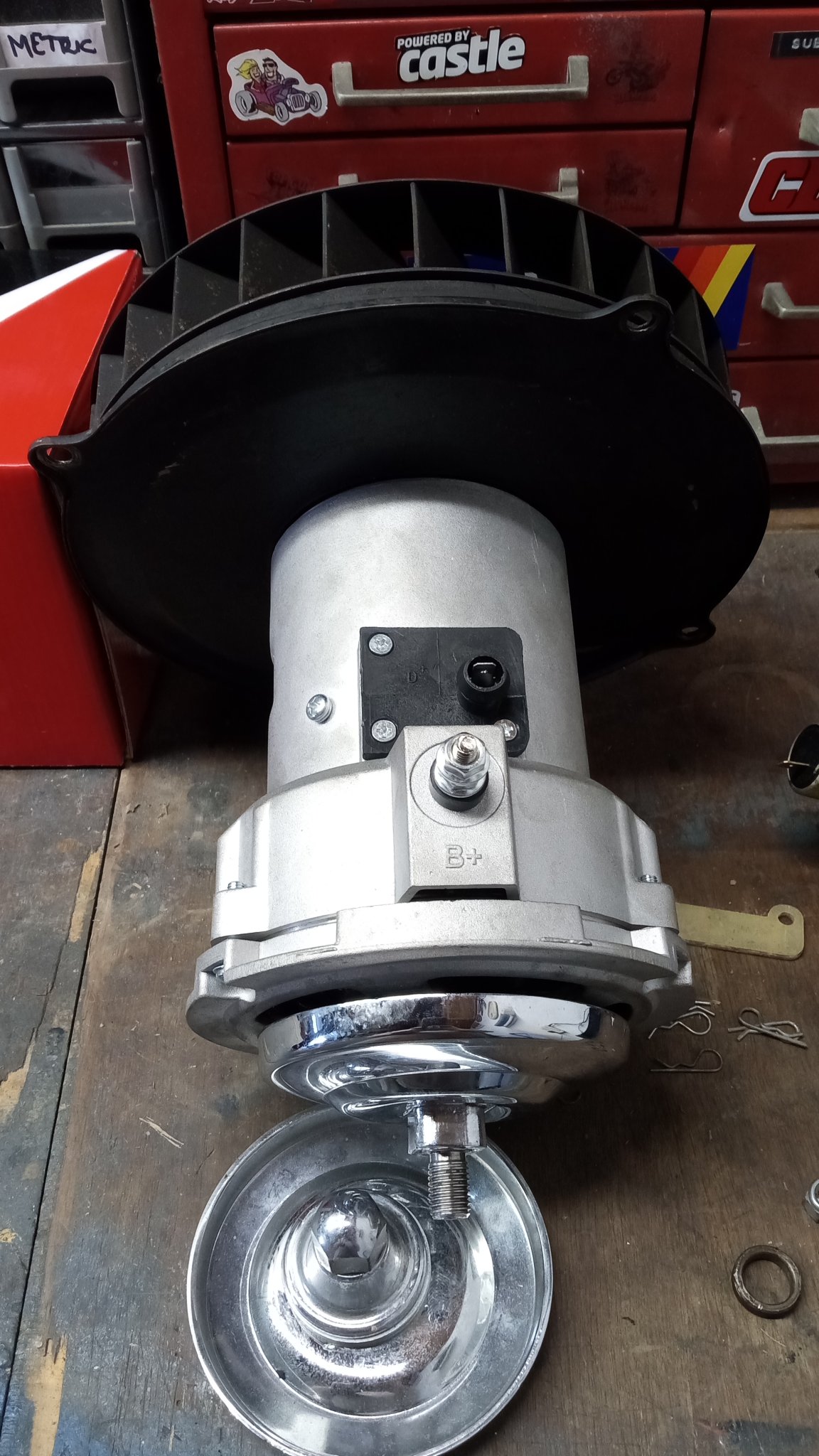

well i did what i didn't want to do. pulled the carb off so i could get the alternator off. so yeah... weird intermittent charging alternator is off now. need to go buy a new one. not happening today. not happening tomorrow. idk when it'll happen.
sense we can't just let Maddel make all the progress on his car. i broke down and went to So Cal Imports and bought an alternator. nothing fancy, just an AC industries brand (So Cal's house brand. seems like good stuff, my rear brakes and master cylinder are AC Industries and they work good) 55 amp natural finish. so i guess i can start putting things back together again.

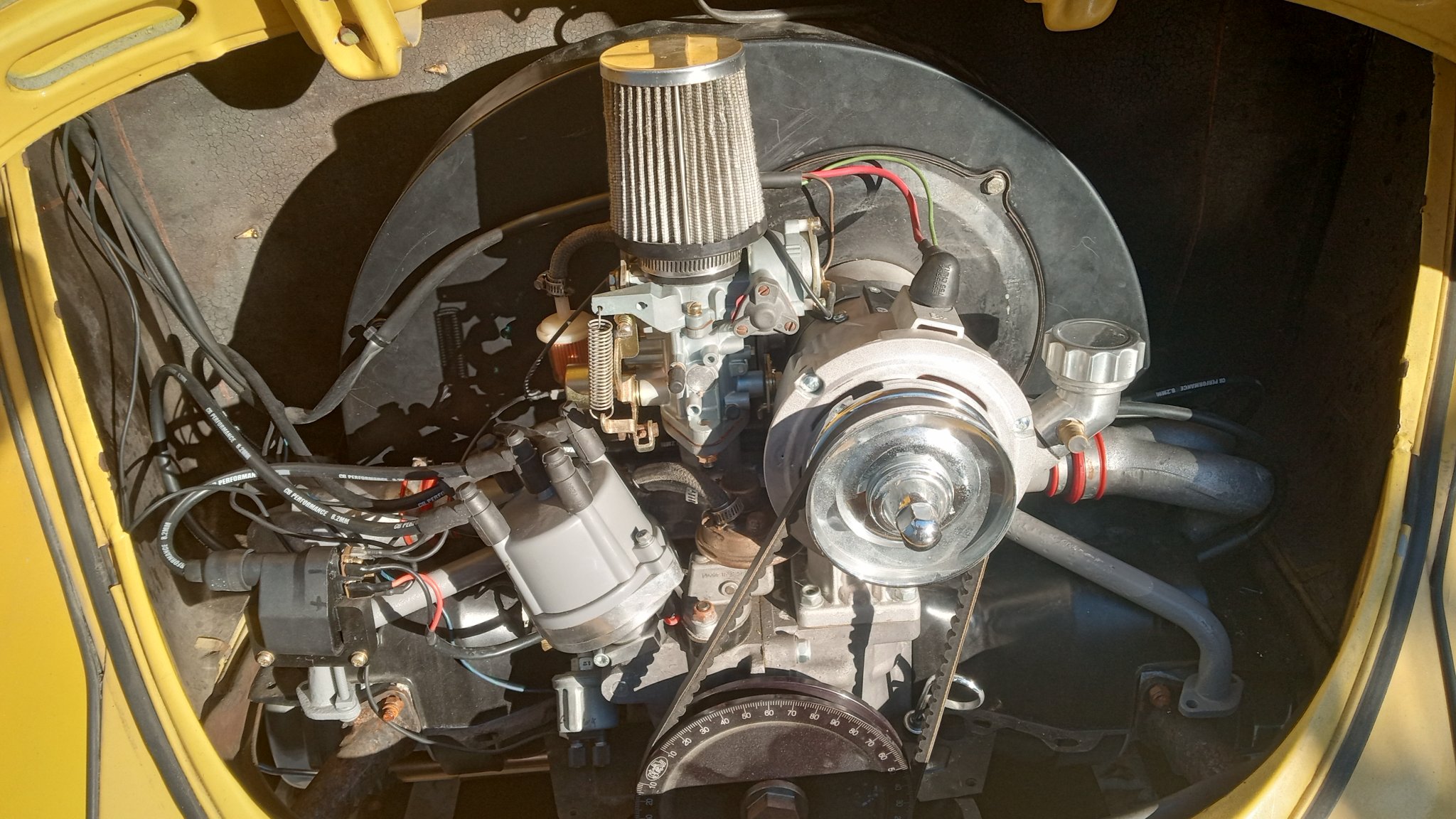

well its back together.
and after tightening up the clamp, the damn fan is just barely hitting something inside the shroud in one place cause the fan has a slight wobble to it. say it with me "self clearance" :evil:
You know, I've only messed with the generators and fans a few times but every time, I've had a rub when it was back together. I handled it the same way you are.
